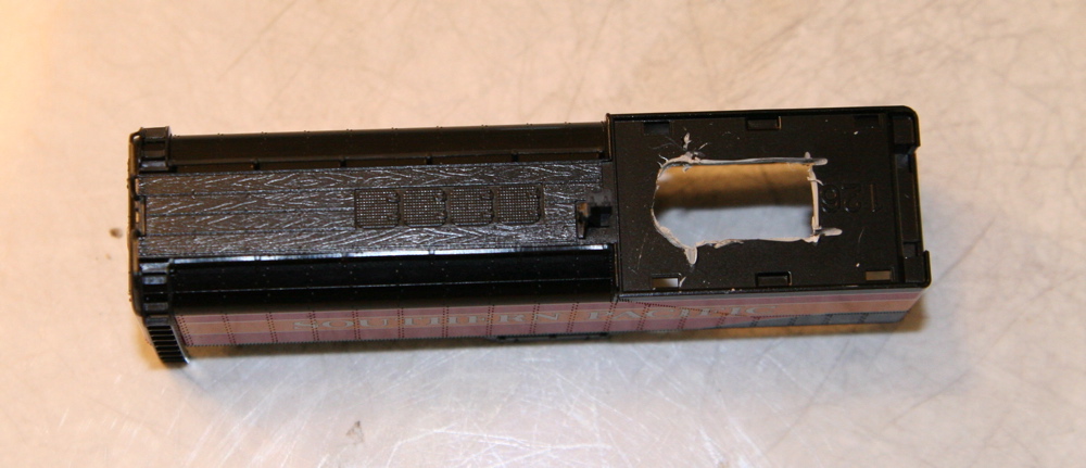

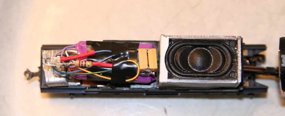

Hi Roger.
Yes you need to buy a speaker.  What I do is buy 14x25mm ovals from DigiKey Corp and build an air-tight speaker enclosure out of 1mm lead sheet.  This makes the final speaker installation 16mm x 27mm, which will fit nicely inside "big steam" tenders.   For cramped installations, I use a 15mm round inside a round enclosure (from Soundtraxx) that I fill with lead shot (make sure to insulate the speaker lead connections!); this provides additional weight.
Here are a few photos of my GS-4 installation.  First is a close-up of the Lenz Silver Mini installed in the boiler:
I use two separate 3mm LEDs for lighting, one for the Mars Light and one for the regular headlight to get rid of the god-awful Kato stock lighting.  This install requires a bit of modification to the Kato pickup board and the light-pipes, but is really pretty straight-forward.
Here is a photo of the TSU-750 and speaker installed in the tender:
Notice the 3mm LED at the far back for the backup light.  The two small yellow rectangular things are 220uf Tantalum chip capacitors that replace the standard round electrolytic cap for keep-alive power for the TSU (to avoid dropouts on less-than-pristine track).
Finally, a photo of the shell with a hole cut above the oil-filler detail for sound egress:
The whole install took about a day, including figuring out how to modify stuff to fit.  But it sounds great (IMHO, the speaker makes all the difference, along with judicious use of the Tsunami equalizer).  Here's an older (non-HD) YouTube video showing the GS-4 running around my old bedroom layout:
