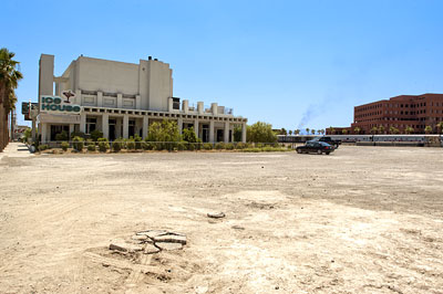

Posts: 3593
Train Talk Media
+3991
Re: Paint color for the Walthers Ice House
January 29, 2013, 06:23:38 PM »
http://www.noehill.com/nv_clark/images/pfe_ice_house_vegas_empty_lot_thumb.jpg
http://i167.photobucket.com/albums/u156/Capndick/icehouse005.jpg
http://www.modelrailscenes.com/assets/images/kits-trackside-131104.jpg

Thanks for the pictures chuck.The 2nd picture really caught my attention.Is that a Ho Kit,the n scale kit does not come with the ramps that fold down on top of the reffers.Does anyone know how far the main buildong is located from the loading rack.Is it flush or maybe 3 feet from the building?
