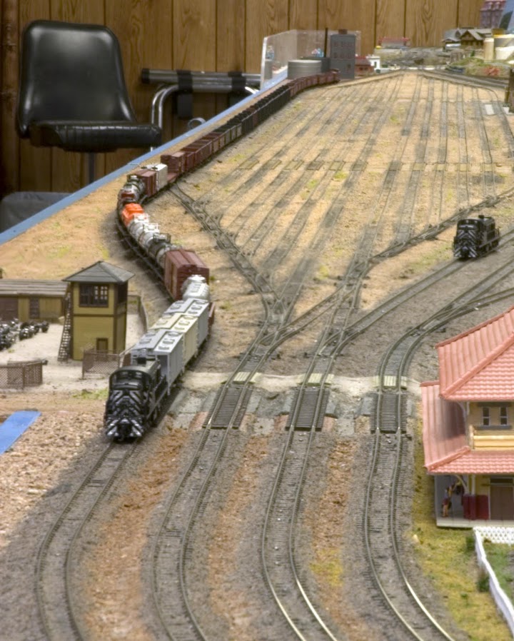

Bob Woods 85-car RSD-4/5:
Many of them were lightweight hoppers. This was taken before Helicon was announced. I manually stitched together three exposures and still didn't get enough depth of field.
