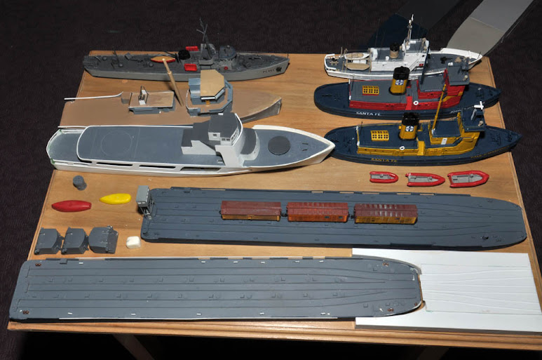

My workbench is so full I had to move the completed items all over the house. I've shown nearly everything here before, except for the 173' minesweeper (second from top on the left) and the dock for the Santa Fe barges (bottom right, in white). The minesweeper and the 210' cutter below it are nearing completion; all the deck details have been mastered. Custom photoetch (especially railings) are either in-house or n production.
Most of the small parts and many subassemblies will be available separately.
