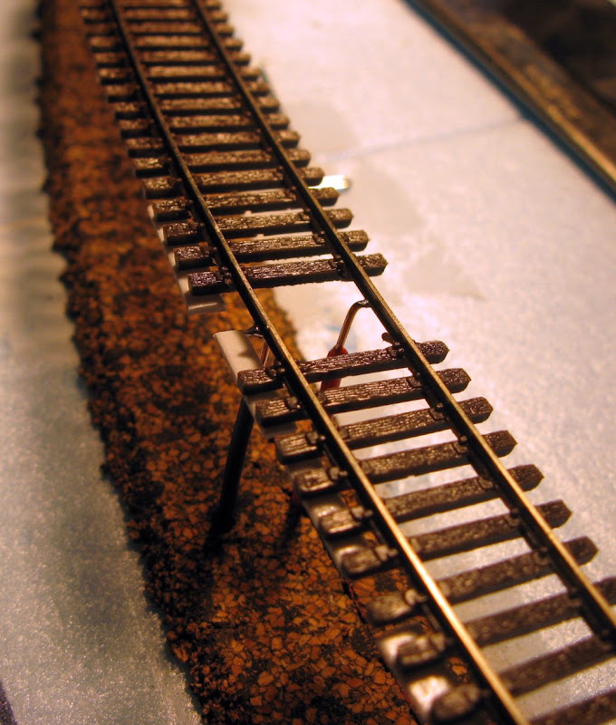

My method of avoiding melted ties while soldering. I wet the paper towel pieces after fastening them. I used to wrap it under the track, but found that simply laying it on top works well.
Superelevating a curve using plastic cut from a Garage Sale sign.
