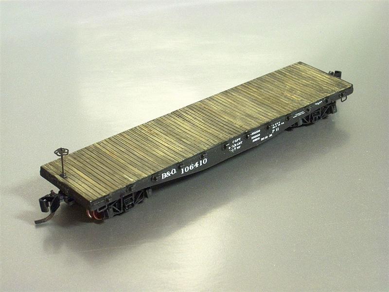

Re: Weathering rslaserkits' conversion decks
« Reply #3 on: June 17, 2012, 12:31:35 PM »
 here's the deck I did for the Atlas car. I used some alcohol stains I found at the local craft store ( espresso, rust and sunburst were the colors)
plus the std India ink and alcohol mix. I then used a small brush and hit each board till I liked the look. For a more weather beaten and worn deck hit it with some 60 or 80 grit sand paper to get some grain than use a shape knife and make some gouges from moving  stuff on the deck .
 On the laser board insert for the MT deck used weathering powders  to get a weathered rusty look. I use Bragdons which do not need a ocer coat to hold in place.
hope this helps
rich
