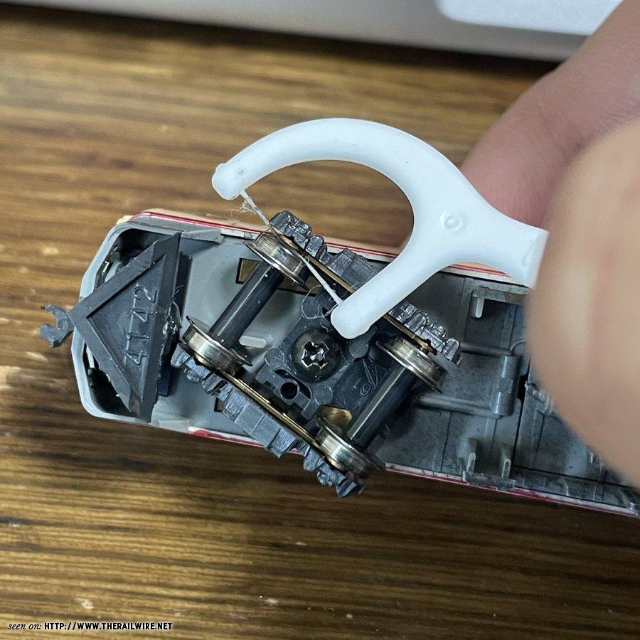

Posts: 19691
+6986
Re: Any tips for cleaning Kato passenger car wheel pickups?
Reply #19 on:
October 15, 2024, 05:07:23 PM »
Not my idea, found the pic online.
OldEastRR
Posts: 3801
+518
Reply #20 on:
October 17, 2024, 04:17:39 AM »
I was wondering what to with this thing the dentist gave me!!
Posts: 10607
+1774
Reply #21 on:
October 18, 2024, 01:54:59 AM »
I do floss my teeth, but have never tried one of those, or been given one by my dentist. Surprisingly, I see a lot of them discarded in the employee parking lot at our auto-parts factory.
I, and the hygienist when I have my teeth cleaned/checked, just wrap the floss around two fingers and go at it!
Never though to try one for cleaning truck pickups.
Dwight in Toronto
Posts: 912
+529
Reply #22 on:
October 18, 2024, 07:55:25 AM »
A lot of floss is “waxed”, so who knows what detrimental remnants THAT might impart.
Posts: 10607
+1774
Reply #23 on:
October 19, 2024, 02:46:41 AM »
All of mine is. My teeth are close enough together that it's almost impossible to floss them with unwaxed floss.
Incidentally, I've been using dental floss to sew buttons back on shirts for the last 50 +/- years. Once on, the shirt usually wears out before the button comes off again.
