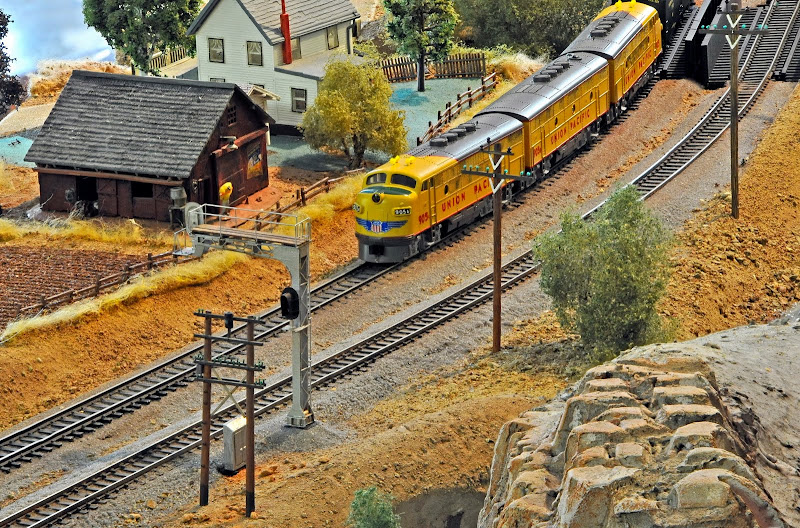

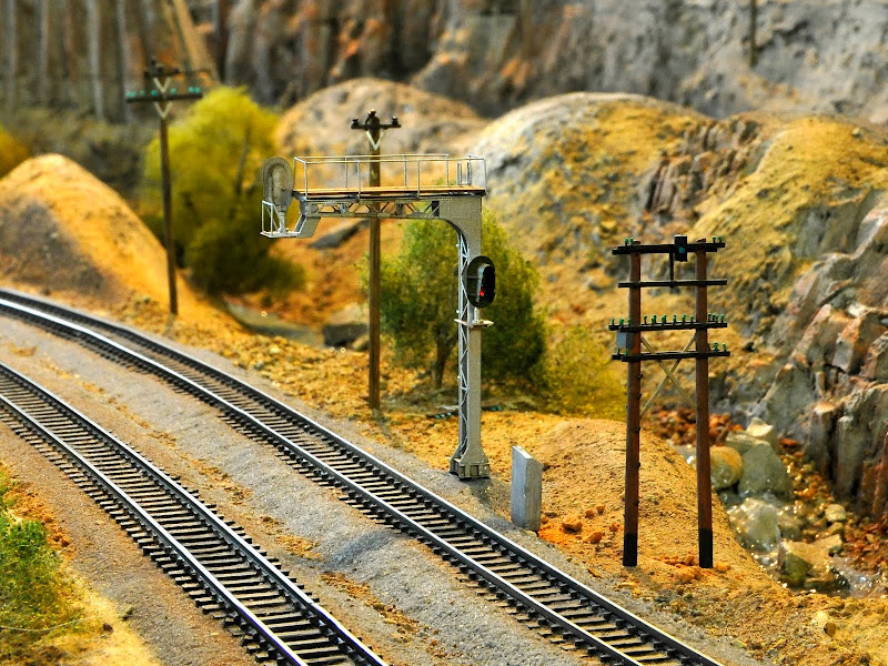

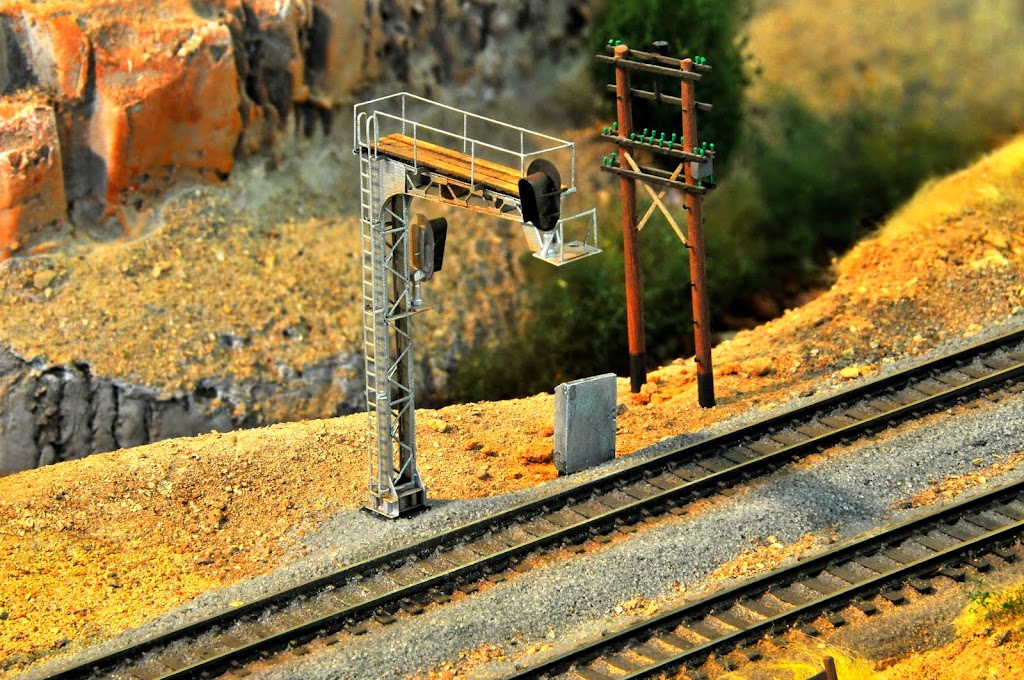

  Photos of a completed Train Cat Union Pacific Cantilever signal bridge installed on my layout. This much modified kit was built for me by Bob Gilmore. He had to use a bending tool to bend the kit parts,there is much added detail railings and ladder, wood top platform detailed, he had to fabricate the signal heads which have MV Lenses installed. Now I hope I can link directly to the photo instead of just showing the data link. Well ! Here goes   Nate Goodman (Nato).Salt Lake, Utah.

  Thanks for all the Paste and Copy information ,everyone. As I noted in my first post, the kit as it comes is not easy to build without tools like a bending tool, which Bob Gilmore who built the kit for me used to bend kit pieces. The signal is non operational,MV Lenses are used, the red in the photo is reflection from the lens.The heads were made from scratch by Bob as well as the attachment hardware. None of this comes with the kit. Protype photos were studied to determine where the lower head should be attached and its angle towards the track. This varied by location on the railroad,also snow shields over heads at some locals. The bridges and heads were originally painted black,but by the late 1950's 1960's to present era I'am modeling bridges have been painted silver with black heads. Nate Goodman (Nato).

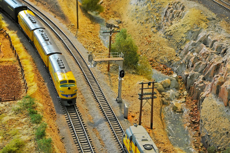

  Here are the three other Signal Bridge photos. Nate Goodman (Nato).                                                                                                                                                                                                                                                                                                                                                                                                                                                                                                                                                                                                                                                                                 http://lh3.ggpht.com/_Rm39RNT1_z4/TM-LvLgbwAI/AAAAAAAAAk8

 Ok! For all you UP Rivet Couters out there, Union Pacific's passenger F-3 diesels had two headlights on the nose. Kato's early model which had only one and no steam generators on B units, I had to add this, but did have the 1948 passenger numbers is what is pictured. I have not got around to adding the second correct headlight. Nate Goodman (Nato).
