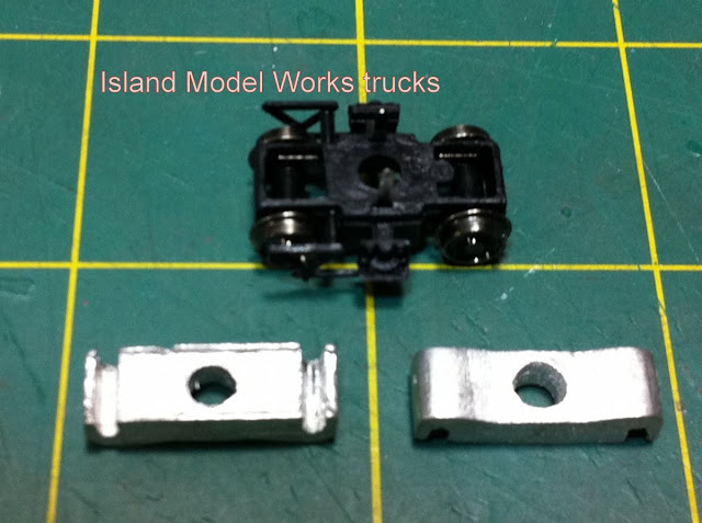

Bachmann inside bearing truck top
included IM "trucks" bottom
I cut the molded on stabilizers off as they were oversized and so thick they would have prevented the trucks from swinging. The Bachman trucks have the stabilizer on them which swing with the truck, although they are not right for the Comets I can live with them.

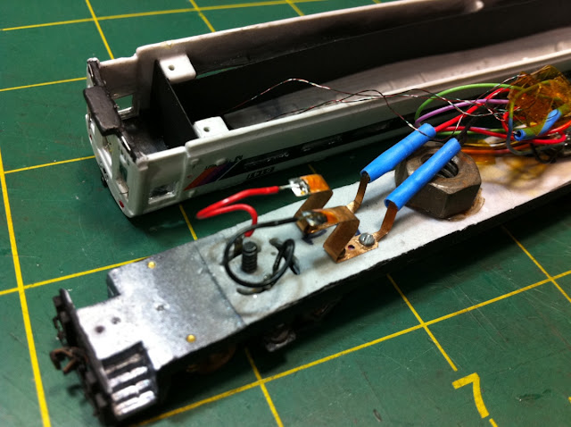

IM Comet II cab kit with Bachmann inside bearing trucks, BLMA E/F model style cut levers and 18" grabs, GMM wipers, TCS FL4 decoder, Ngineering LED's & resistors, Gallery Glass ruby red lenses, .030" fiber optic, custom built styrene pilot and diaphragms, Kato 5 chime horn, Microscale decals, MT couplers (Z scale on the cab front)
Coach and cab
Decoder, LED's & electronics
Power pickup

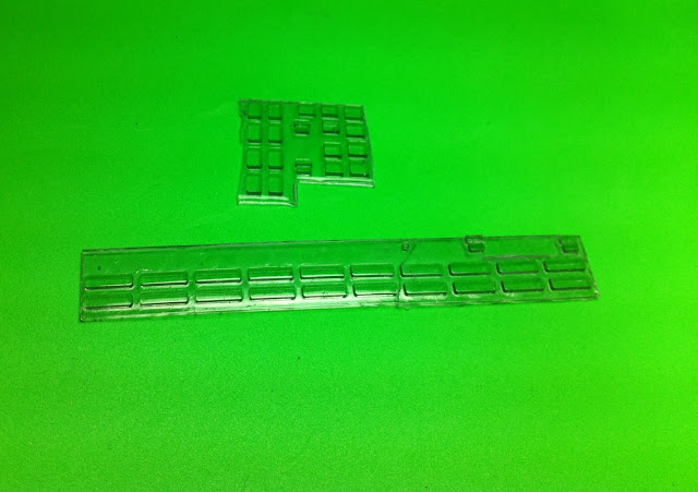

The windows could be filed/sanded to fit flush flush but I didn't bother to do it as the NJT cars are so blacked out looking anyway. According to Joe at IM they no longer include the glass as most people were just throwing them out. He did say he had some left and would send them if I asked when ordering.
this is what the glass looked like
 So each one had to be cut and glued separately, one score with a #11 and they snapped crisply.
