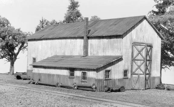

Well, the masking tape I've used certainly isn't very thick.
It's definitely much thinner than the self adhesive tar paper roofing supplied by AMB and others.
There's scores of ways to skin a cat.  I'm only offering a suggestion.
I don't feel it looks out of place.
The model in your photo is well executed, but to my eye, the roof looks like what I think is called “roll roofing” which is a roll of asphalt shingle material that is laid down as a long & wide strip instead of individual shingles. A tar paper roof is just the asphalt impregnated roofing felt that is typically used as an underlying layer for the layer of shingles. You see it used mostly on sheds.
As for electrical tape, it’s a reasonable impression of roll roofing if you apply chalk weathering powders to kill the shine of the plastic tape.
