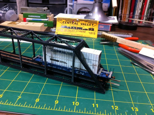

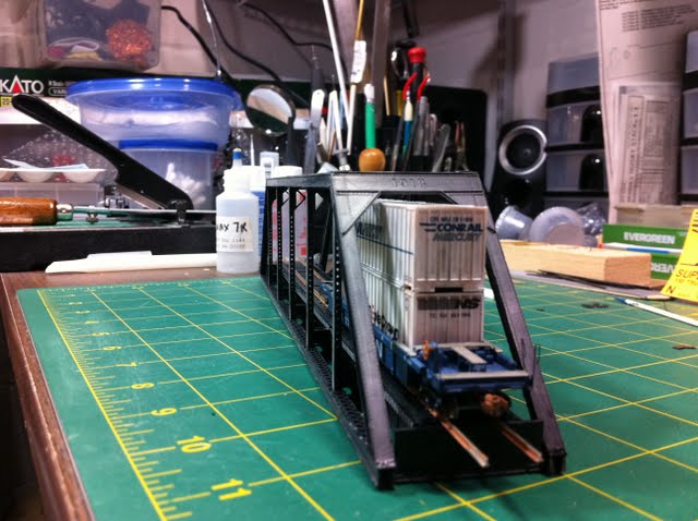

Correction on the  CV #1815 bridge kit stats. I went ahead and assembled my kit last night as I couldn't resist once it was open. The overhead clearance at the portals is 22' 6" and width 16'6" (final answer) My earlier measurements from mocking it up were way off. Sorry about that. Another 4"-6" could be added to the overhead clearance by sanding the end portals inside top edges level to the track. The ME code 55 track slid in place easily and crimping the plastic spike heads went fast and without any problems.The kit was a lot of fun to build, and is very sturdy completed. I still have to add the gussets and diagonal braces then paint and weather it but it already looks good I think.

Ok, still good.  ;D 22' is the bare min required for double stacks.

Nice upgrade to the Walthers stack car too Alan!

Thanks,they sure need it. Since I did that one I've been using BLMA trucks with MT underslung couplers to get them to ride lower
