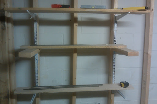

Tim, I've actually looked at your web site many times on how you did the brackets (and helix). The one image on your site I'd really like to see bigger is your cross section one, as I think that would answer a number of questions of probably not just mine but others as well. My shelf brackets are flat, so there is no slope to them so I don't really need to worry about any height difference. My question is probably better illustrated looking at a picture of the mock-up I was doing.
So if you look at the bottom shelf (as was in Tony Koester's double deck book) you'd screw the plywood directly to the brackets. Another alternative is to put 2x2 or something like that underneath the plywood, like the middle shelf (I used scrap 2x4s) to elevate the subroadbed off the brackets and have room for wiring. I think you did, based on what I can tell from your photos, was put the runners at the front and back and then place your modules on top, kind of like domino construction on shelves. Another option I'm thinking is using the 2x2s with plywood but then alternating to using risers screwed to the 2x2s where some eleveation between the subroadbed and brackets/2x2 frames are needed to model ditches, creeks, underpasses, etc. And others would put the plywood on top of the brackets and then use foam, which is also an option, to adjust elevations, etc. I know Bill Darnaby's layout is just foam, but he mentioned on an MRC show that it was extremely noisy and would have suggested a thicker plywood base. Again, I'm just experimenting and gathering enough information before I go off and either purchase more plywood or more standards/brackets. Thanks,
Phil
- Phil

Chris, interesting, that's kind of what I was thinking with the 2x2 blocks on the brackets themselves and then attach risers to the brackets, you guys just also have the small plywood base underneath. I should also mention I was going to put 1x3or4 on the front edge to connect them all,
Phil
- Phil
