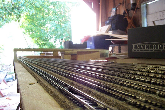

what would be a good track spacing for a "hidden" staging yard.  is 1.5" too close?  should i go to 2 inches?

I would say for a hidden staging yard, where esthetics are not as much a concern, going to 2" would be a good idea. On the yard on my last layout, my "exposed" yard had 1.5" track centers, which looks better, but makes it tough to get big fingers in between the cars for rerailing and the like.  Try setting up some temporary track to see what you prefer.

I have mine planned for 2.25" plenty of room to man hand grab items.

Mine are at 1.5, but I wanted to get everything as close to the aisle as possible.  It can be a little dicey if some moron wrecks his train below decks, but I'm trying to take notes as to who does and doesn't get a throttle...
I've also found that on those rare occasions when something does go ka-boing, it's easy enough to just pull the other trains out of the way to clear the spill.

i might go for 1.75" spacing.  i'll play around with it - the only autoracks i'll have are open top and only a 6 or 8 of them total.  with an 8" clearance i should have no problem getting in and fixing things.  i'm also planning on having rerailers at both ends of the staging tracks.  once the book case gets moved tonight, the other section for the staging level can be installed and real planning be started.
