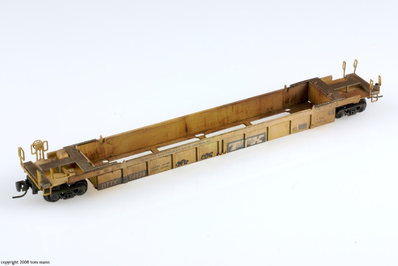

I tend to agree with him that the graffiti stands out a bit too much, maybe because of the thickness of the characters. If I were you, I would go over the whole unit again with another round of chalk or powder (maybe preceded by a fade coat like you did on the Evergreen can). When I did one of these in N, I literally ground some Bragdon powders into the sides with as much gusto as I could, and even then I don't think it was too much (at least to my eye, and compared to the photo I was working from). Here is a sample shot:
One thing I did when applying it was to wipe off the upper side sill and the thicker vertical members with a damp Q-tip because those elements seem to stay cleaner than the rest (like in the photos Ed posted).
Keep posting! It's good to follow your progress.
-gfh
