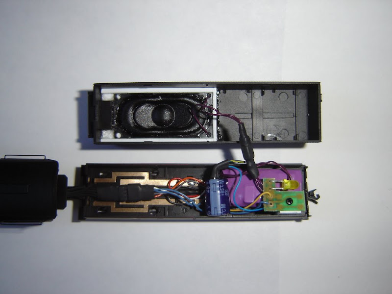

just took this one. It the best one I have of the overall install in the tender.
I like to use micro connectors from Miniatronics for my speaker and tender connections so I can remove these pieces easily for work down the road. I'm also not stuck making a new form of storage for the unit since the tender is not permanently attached to the loco.
I also cut out the stock rear light support and made my own out of styrene to make room for the decoder.
