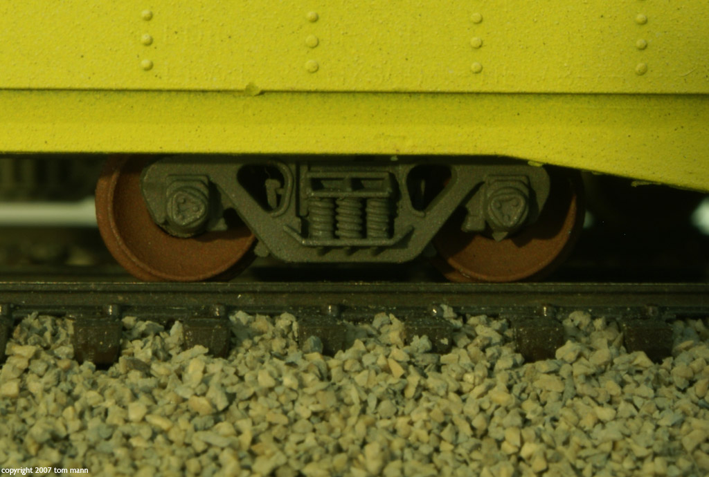

I took this not too great shot to show how the wheel looks with a coat of rusty metal primer.

Why do plastic [delrin] wheels have to be black or brown.  Why not cast them in a silver or metallic color.  May not look like shiny metal but after panting the face might look pretty good.

Geez Tom, I can almost smell the grease in those roller bearings...  These wheels cost how much?
If they were molded in silver, the tread would just turn black anyway from all the grime the plastic wheels tend to collect while running.
