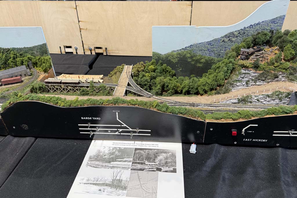

OK, "Barge Yard" is officially "done", boxed up and ready to show at Altoona in September.   Along with "East Hickory", which has a surprise to show that I don't want to preview.
But here's how it came out.    I'll confess to doing some photoshop editing with the clone stamp to clean up the backdrop when I shot it outside to take out the side of my garage and the modern light poles, etc. visible across the creek.   I love taking Ttrak modules outside for photography and that is 'real sky and real trees' behind it.
(I think my photo link problem is gone, but for this post, I'll include it anyway.   If you cannot see the image above this line, please PM me with what browser and reaction you are getting because I think I have it fixed, finally)
link:  http://www.randgust.com/BargeYard08sm.jpg
Remember what you are looking at is the eastern trestle approach to the Hickory Bridge.  That's the single track module of the river bridge that's been at Altoona forever.
Link:  http://www.randgust.com/BargeYard09sm.jpg
Link:  http://www.randgust.com/BargeYard10sm.jpg
« Last Edit: August 24, 2026, 03:12:46 PM by randgust »

Got it done and down to Altoona for N Scale Weekend.
I hadn't shown East Hickory because I have an Easter Egg on it I wanted for the show.   If you look closely, you'll see a Barnhart log loader, a log car, and a Shay up on the hill.   This is the interface with the Ross Run logging module as well - the two Hickory Valley Railroad modules.   So the backdrop has to climb up there as well.   The lower 'hidden track' off of Ross Run plugs into one of the two Ttrak mains as well, so this does complete double duty either as a stand-alone single, paired with Barge Yard, or the connector to Ross Run and the Hickory Valley layout.
The Easter Egg is that there's a David K Smith inspired feature - the log loader slowly, and silently, rotates between loading the log car and picking up the log off the hill.  Big hit at Altoona.
My friend Lee gave me a great idea.   The backdrop is configured to handle fitting "Hickory Bridge" on to the bridge approach and is open, but he suggested I come up with another removable backdrop piece to 'plug the backdrop hole' when it's on a Ttrak layout.   Yeah.   Duh.   Why didn't I think of that.   So I still have stuff to do, but I can't come up with that photo until about next June.
« Last Edit: September 15, 2026, 09:17:06 PM by randgust »
