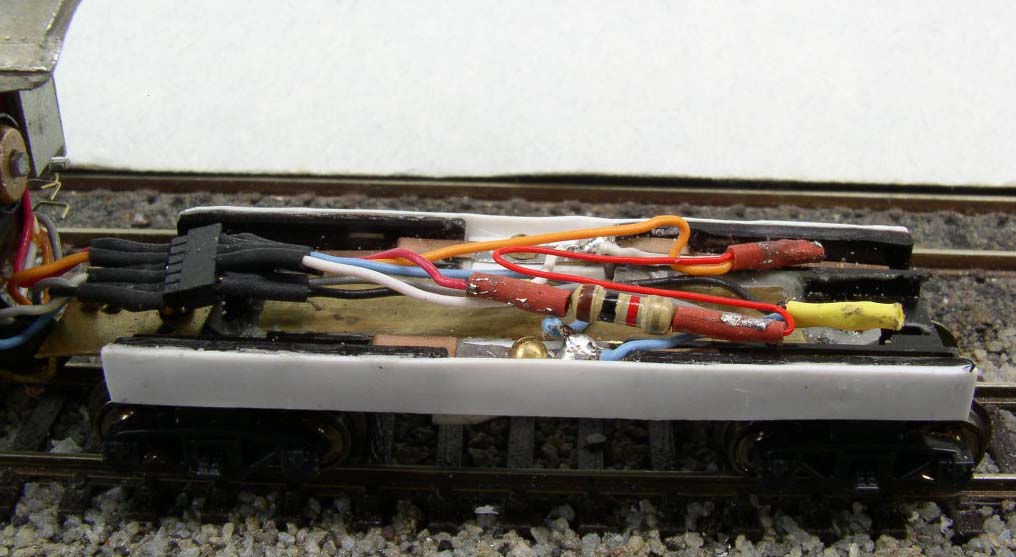

This is my 'raw' tender bottom for the I1 before I converted it to DCC.   You have two wires coming from the track pickups on the locomotive (isolated from the motor), two wires from the motor, two wires from the headlight.  The resistor is for the headlight.  The pickups are under all this.  And at least for the Trix shell, I had to add .020 styrene to both sides of the Kato caboose frame to set up the fit.  And the TCS 6-pin connector is in there.
I buy entire Kato 'shorty' cupola cabooses and scrap them out.  Frames and trucks go to tenders, along with pickups.  Steps get cut up and go to passenger cars.   End railings go to other cabooses, same with smokejacks.   Useful collection of parts.   When Kato was putting these in train sets they kept showing up on Ebay for around $20.  I think those days are past, just saw one listed for $99 with lights!
Link:  http://www.randgust.com/PRRI1021.JPG
I've had such 'fun' with DCC that I broke down and did this a second time to make an 'all DC' tender body so I can swap it around.  That also means that if I isolate the motor and bring the wires back, I can take another Decapod or even a 4-6-2 and put DCC and sound on it simply by swapping tenders.
