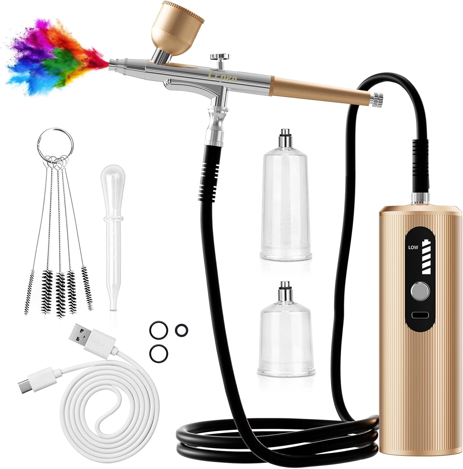

I have been meaning to post this for a while.
Earlier this year I purchased this unit from Amazon.  The kit comes with a 3 foot hose to allow for remote compressor use.
https://www.amazon.com/dp/B0CP82T1CD?ref=ppx_yo2ov_dt_b_fed_asin_title&th=1
I LOVE THIS THING!  I have been using it exclusively, with stinky and water based paints. Really low overspray when I painted a recently added spur to my layout using old Woodland scenics paint.  I am utterly sold on this airbrush and I think its a great investment for me.
I decanted some Tamiya primer, and sprayed that right away (after the propellant was gone) and it worked perfectly.  All of my recent printed models of aggregate equipment have been painted with this.
I have never tried spray weathering, but I might now with this thing.
I only made one small modification to it- the metal cup had a burr at the bottom that would keep some paint in the bottom, so I used a 3/16" diameter spherical grinding ball to remove the burr.  The cup is aluminum so no rust.
On a second note, I have converted to cleaning it using acetone from a can of Brake Cleaner.  You can use the nozzle tube to power into the mixing chamber and through the nozzle to blast out any residue, a plus is no pouring or messes.  A light press of the nozzle into a small stainless cup provides enough fluid into a washing bowl if needed.

I have not been able to use the full battery time yet.  I have let it sit for weeks and have a near full battery when I return.  I think the reason I want with this one is the max pressure output, at 35psi, but 48psi is huge.

The button on the one I posted controls the on/off and the pressure. I have not tested the accuracy of the pressure, but I am sure it can be done.
