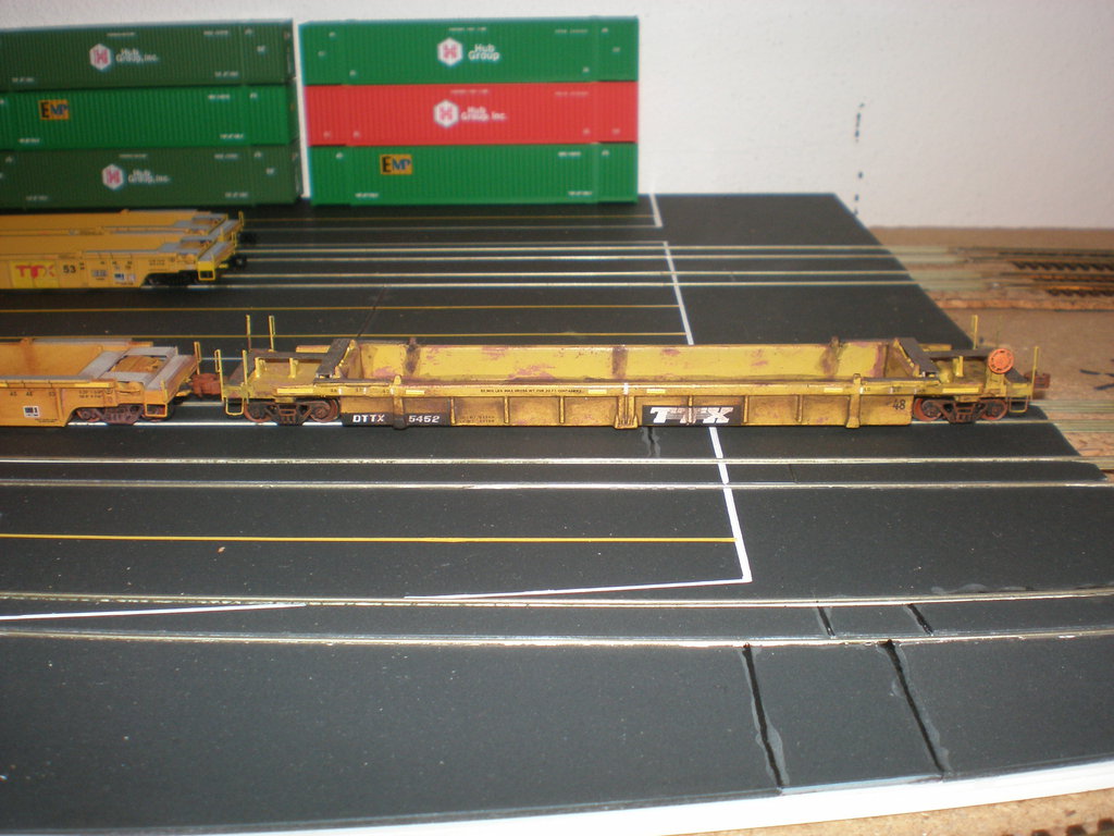

I guess I’m going to divest myself of my Walthers 5-well sets (2 TTX and 1 Santa Fe) and my 3 car/well TTX set…
I have a couple of Kato TTX Maxi 1s and Maxi 3s plus a number of JTC cars… sure would love some new 40’ Thrall wells and new-tool Twin Stacks!
