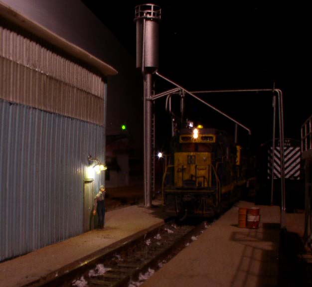

Yeah, I've done the full deal on my original ATSF layout with functioning signals, fully lit passenger cars, town and building lights, and enough yard spotlights that limited operations can run if you're careful.
And it's universal, people really like the layout in the normal daylight, but power the lighting system up and it's simply spectacular.   The ability to light stuff with the tiny LED's is amazing, first real try at it was my Winslow shops fueling rack and it's still just awesome.  I also have a subwoofer under this scene with a continuous loop of EMD idling.....
Link:  http://www.randgust.com/Winshopnight02.jpg

I'm using a mix.   I have multiple circuits; still use incandescent for most building lights, and supply them at way lower voltage like 6V, I don't want the entire building glowing and I want that yellow light.   Then I have a higher voltage lighting circuit for spotlights as those old Miniatronics ones are all bulbs, want more power there.   Then I have two different circuits for LED's, a power supply line for anything that has it's own resistors, and a low-voltage line for misc. LED's without resistors.
Most of the time you don't want to supply much of anything at it's full rated voltage.  I also run everything on DC, not AC, so I can control it with old train transformers, MRC rheostats, etc.
