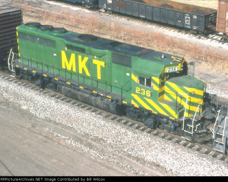

Couldn't get verification they are amber. It looks like they were all over the map on styles.
Here is a video of the strobe in action. You can see it is much whiter in comparison to the headlight, but I wasn't sure if that was due to the light blowing out the camcorder sensor.
MKT 236, fellow ex-Conrail brother to 245
https://s3.amazonaws.com/rrpa_photos/55350/MKT+236_1989-10-26_GP40_Grand+Avenue_St+Louis+MO.jpg
This looks like a 6" wide white strobe, about 12" tall.
