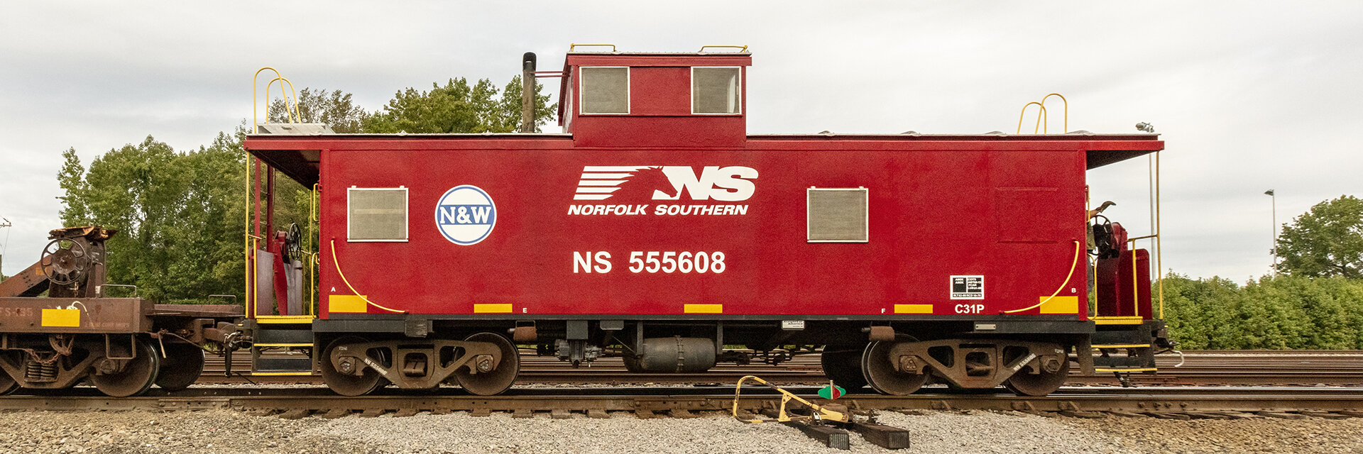

Atlas NS standard cupola caboose with N&W Decal
« on: March 26, 2022, 08:15:12 PM »
The standard cupola caboose that Atlas did, the Norfolk Southern version with the circular N&W Decal on it. Was it prototypical, or was it fantasy?
Thanks

« Reply #4 on: March 27, 2022, 03:22:48 AM »
Isn’t that cupola dead center?
central.vermont
  • Posts: 2627
  • Jon
Re: Atlas NS standard cupola caboose with N&W Decal
« Reply #5 on: March 27, 2022, 07:18:14 AM »
I believe it is and only one year later the yellow in the logo faded out too white!!!

« Reply #6 on: March 27, 2022, 09:48:04 AM »
Based on how vibrant all the colors are on the later picture, I tend to think it was a repaint rather than a fade. I'm not convinced yellow would fade to vibrant white in only a year.
« Reply #7 on: March 27, 2022, 10:01:01 AM »
Good eye - the caboose is a N&W C32P class (the Atlas model is closer to the N&W C31/C31P class).
« Reply #8 on: March 27, 2022, 12:24:44 PM »
The photo I linked above says it's a C31P class.
So does this mean that the Atlas car is a C32P class of car??
« Reply #9 on: March 27, 2022, 01:44:18 PM »
I am actually not sure (need a good side shot), but I do think this is a N&W C32P caboose.
https://www.nwhs.org/data/caboose/view.php?ID=1745
NS put C31P on the repaint - no idea why!
Here's a better side shot - of a C31P: https://images.squarespace-cdn.com/content/v1/58a9e6fd29687f223f06740e/1595466020409-8XSCF3MWQ71UO2M31QE9/NS+555608+CABOOSE.jpg?format=2500w (this 555608!  :lol:)
My books are packed up at the moment, but from memory the C31 class was built 1969-70  (518500-518699 or so) and has a somewhat offset cupola - this class is similar to the Atlas tooling (cupola windows are wrong). https://www.nwhs.org/archivesdb/detail.php?ID=202895
The C32P class was built 1976 or so and features a centered cupola - these were numbered in the 555XXX series. https://www.nwhs.org/archivesdb/detail.php?ID=165580
Under NS, things get confusing (to me anyway) as some or all of the C31P class have been renumbered into the 555XXX series.
The Atlas model is lettered as a C31P class (like the proto), but the tooling is off for a C32P.  :D
« Last Edit: March 27, 2022, 02:02:27 PM by Mark5 »
