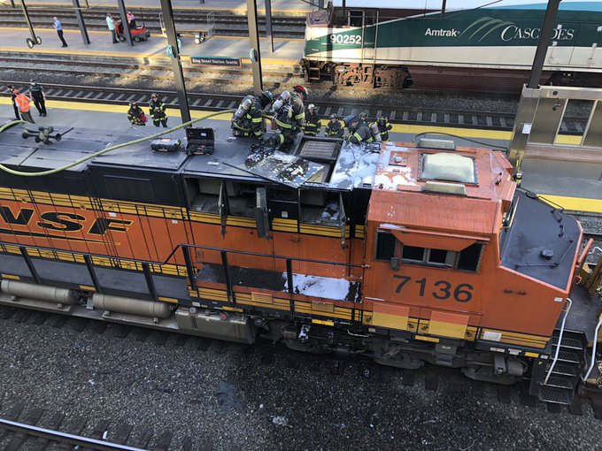

BNSF fire in Seattle this morning
« on: June 22, 2021, 10:49:59 AM »
https://twitter.com/SDOTtraffic/status/1407343752352575488
No details beyond SFD reporting fire under control.

Bet that F'd up the morning Sounder Trains coming into King Street
https://twitter.com/SeattleFire/status/1407346491367231499?s=20

I saw it on one of  the Seattle TV station websites.  Apparently it was in an "electrical compartment in the top of the locomotive", according to the reporter, who may, or may not, know anything about locomotives.
What is up there?  The dynamic brake grids?  Inverters?  Or nothing electrical at all?

Brake grid failure. There really isn't anything combustible up there. If there were an experienced railroader in control there he would have had the crew isolate the dynamics and get the train out of the way. Once all the metal cools off the fire will subside.

« Reply #6 on: June 24, 2021, 02:00:07 AM »
Thank  you!  That's what it looked like, but I've never actually SEEN a dynamic brake grid!
Move a train without dynamic brakes!!  How would you stop it????  :trollface:

« Reply #8 on: June 26, 2021, 01:57:31 AM »
Air brakes.  Same as any case of DB failure.

« Reply #9 on: June 26, 2021, 11:58:09 AM »
It's all flat there anyway, right?  DBs wouldn't even be operating?

« Reply #10 on: June 26, 2021, 12:04:00 PM »
It's obvious to me that they were operating.

« Reply #11 on: June 27, 2021, 12:23:43 AM »
Dynamic brakes can be used on flat ground, as long as the train is moving fast enough for them to be effective.  They're not just for long grades!
One still needs air brakes to stop, as the dynamics aren't effective below a certain speed.  Not enough current from the motors to do any good.  The minimum speed depends on gearing and DB design.
