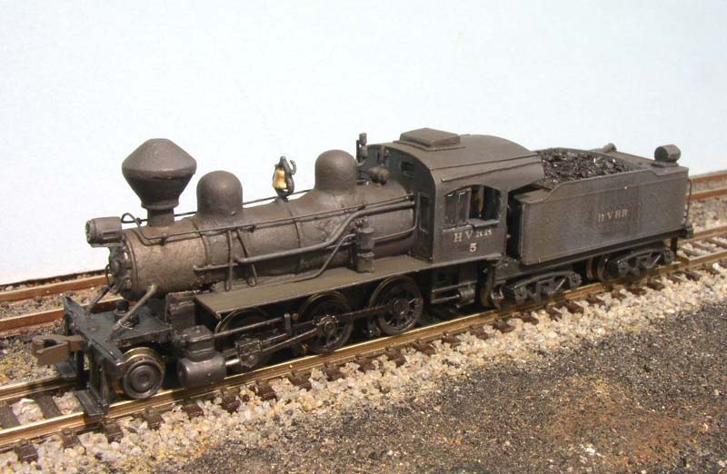

One thing I did make - your choice but I have parts - is the Radley-Hunter style stack like on W&D 7.   I put one on my Lima 2-6-0.  Original is made from turned aluminum and the castings are pewter.   The dome castings, bell, etc. are commercial - see Republic Locomotive Works as the best (and sometimes only) source of this stuff.   This is the type of stack shown on that drawing.
http://www.randgust.com/HVR5042%20final%205.jpg
I will get with you on this at some point . I'd like to get another of your kits as well.
