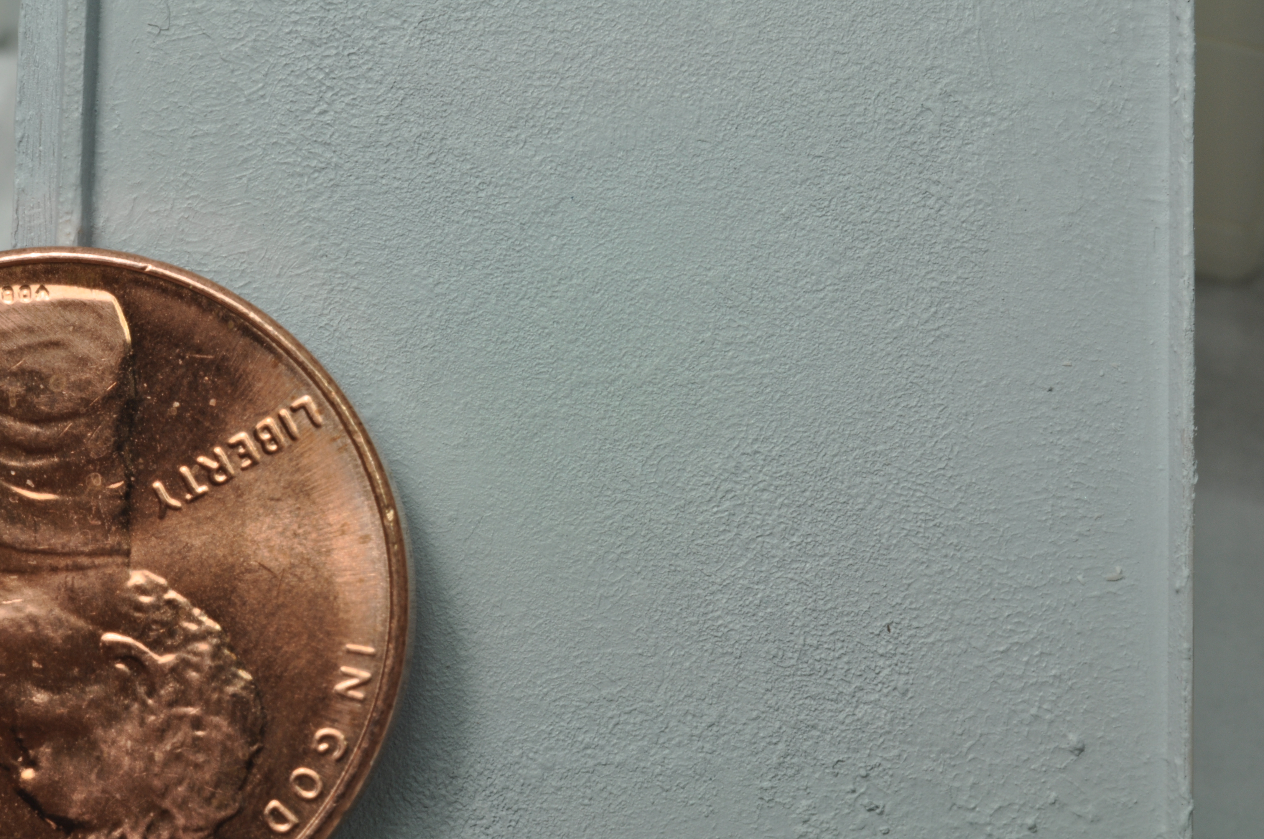

I am in the process of building the station at Kingman, AZ out of styrene. The building has a stucco exterior, I have sanded a test piece and tried to blott on some spackling with a brush, but it will not stick to the sanded surface. New area for me, what are your best ideas for creating a stucco exterior? thanks in advance guys!!! Gordon

I've seen a lot of military and larger scale modelers use something this as a base coat then repaint:
https://www.krylon.com/products/coarse-stone-textured-finish/

Plastruct makes stucco styrene.  I think it looks great.  I used it on my Park Hotel's first and third stories.

When I was trying to make some concrete bridge abutments, I used a makeup applicator sponge (the triangle shaped ones) and dabbed the acrylic paint.  As the paint dried, the texture got finer.

I used the dab technique on the hathaway (https://www.therailwire.net/forum/index.php?topic=31099.msg343090#msg343090).
Scoll down to bottom for pics.
I was going to say the same thing. In smaller scales you don’t need a lot of texture, and a brush and some thick paint is good enough.

I got decent results years ago dabbing white out onto the styrene with the brush from the bottle.
I like the sponge method even better I think, though.
