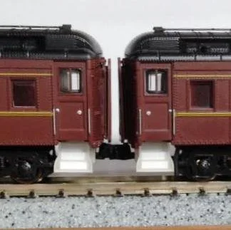

Keystone Details announces three new replacement step/coupler pocket sets to swap into your new BLI PRR P70's for a more appropriate diaphragm gap.  The first is a short coupler location designed for use on no less than 16" track radii.  The second is the long coupler location for track no less than a 12" radius.  The third is a slightly longer location to allow for the depth of an American Limited diaphragms should you choose to install them.  These steps are only designed for use with a Mictro-Trains 2004/4-1 underslung coupler (001 02 051 or 052 assembled) to put the coupler at proper height from the rails.
Mounting instructions can be found here
From this:
to this:
Link to the short version (1.87mm between diaphragms)
Link to the Long version (1.37mm between diaphragms)
Link to the American Limited Diaphragms

@Cajonpassfan see the album. Video through Atlas C55 #5's coming out of a curve, crossing over into another curve.
First pics show the gaps on a slight curve. Also is a sequence of photos staged at the reverses and curves through the turnouts.
https://photos.app.goo.gl/tCaYBFSfDNT7P4Hy9
