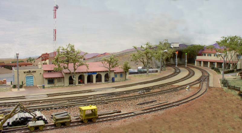

One thing I've done on all my photo backdrops is to simply paint the sky and then cut the sky out of the photos with an Xacto, and mount the building profiles only.   It started because I could never get all the bubbles out, and that I'd already painted a pretty decent horizon-line sky anyway (which is full blue at the top and fading into white at the horizon line).
It sure makes life a lot easier on matching stuff up and making collages.    You edge-paint the paper so that no edges show 'white' and just do the buildings.
The backdrop here is a mix of commercial HO West!, historic postcards, and Google Earth images accurate to location.   Sky is shaded and painted with latex paint
http://www.randgust.com/winsta5.jpg
