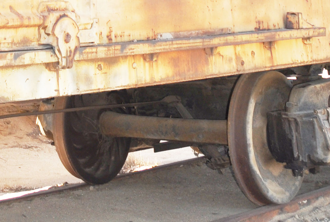

  • Posts: 8956
  • Respect: +1392
Re: How do freight car brakes actually work?
« Reply #3 on: March 16, 2019, 02:28:27 PM »
I went through a bunch of my photos and this might be the best.
garethashenden
  • Posts: 2351
  • Respect: +1854
« Reply #4 on: March 16, 2019, 06:09:31 PM »
Well that’s obvious now that I see it! Thanks guys
