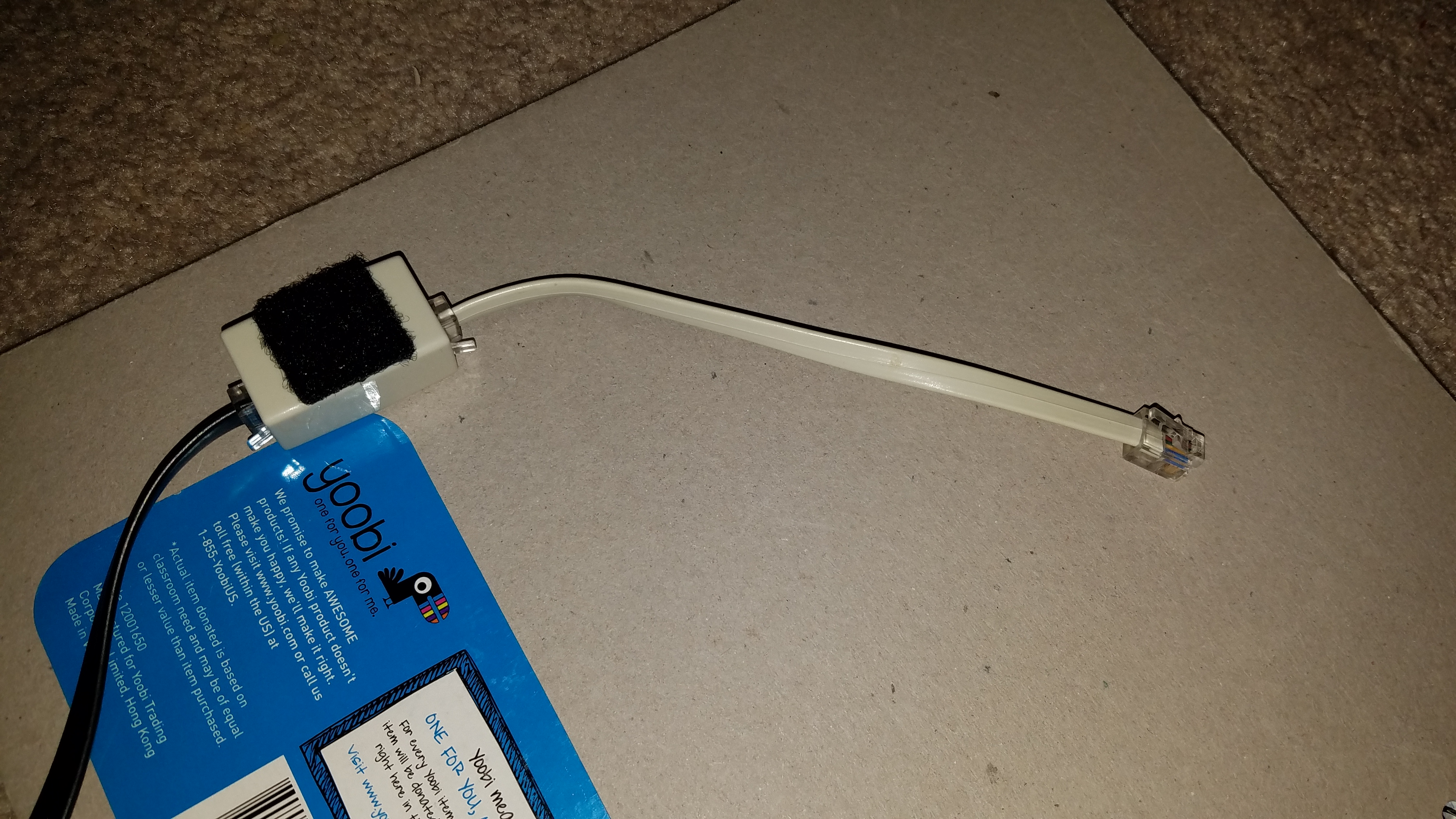

« Reply #8 on: October 22, 2018, 12:08:46 PM »
When I got my DT throttle, it was suggested to make a short extension with an inline coupler and small piece of phone line so the chance of anything breaking would happen to it and not the throttle.

« Reply #9 on: October 22, 2018, 09:48:07 PM »
I did exactly what Jason did.  Then I had it converted to a DT402D.  :D
