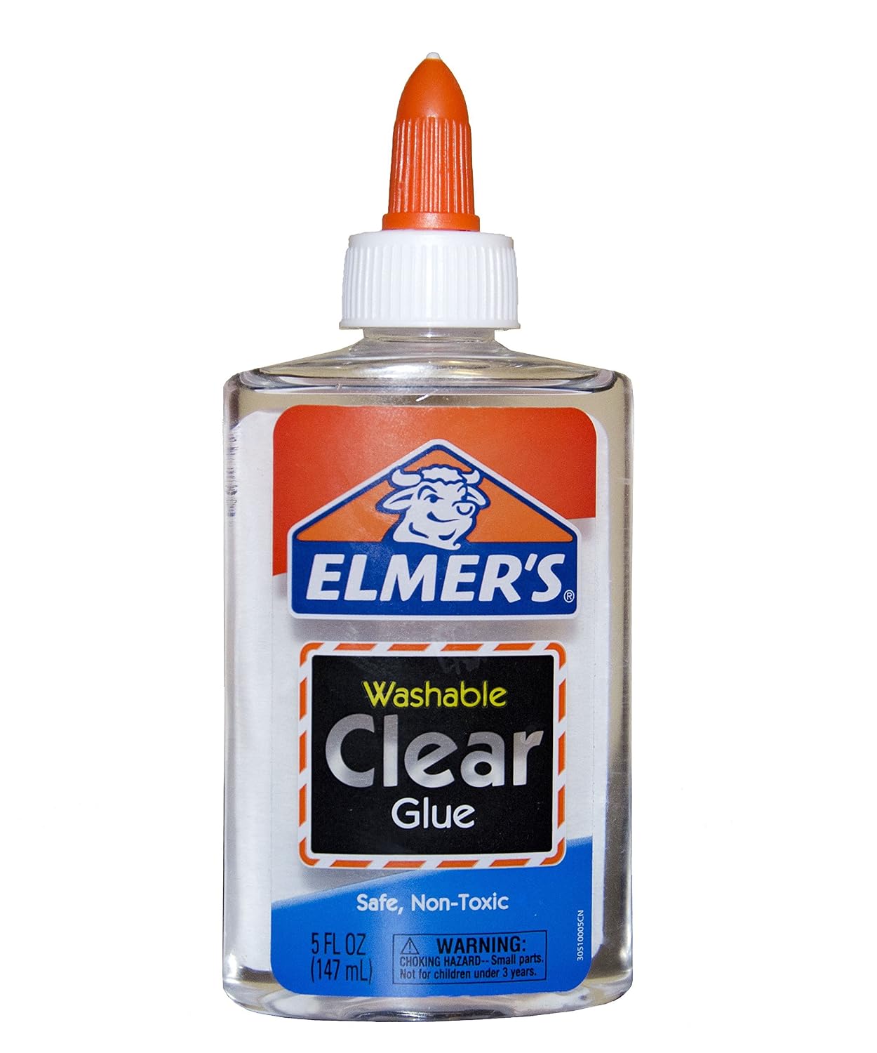

Re: How do I make LED's stick?
« Reply #23 on: March 09, 2018, 12:51:33 AM »
Howdy all,
     I am trying to upgrade lighting in some of my locos. I am having a hard time gluing the 0603 led's to the numberboard/headlight plastic.
     Regular CA just is not working for me. For example..I drilled a hole in rear head light plastic in order to recess the LED, inserted the LED used regular CA..did not hold.
     So what can be done to glue the LED's?
Cya, Y-it
I've actually had great luck with this:
Only $2.50 at Michael's! It's semi-elastic, which means it's in a tacky state when not yet fully dry, allowing you to position your LEDs in place for maximum brightness. Also, you can paint it with black acrylics to avoid light leakage.
