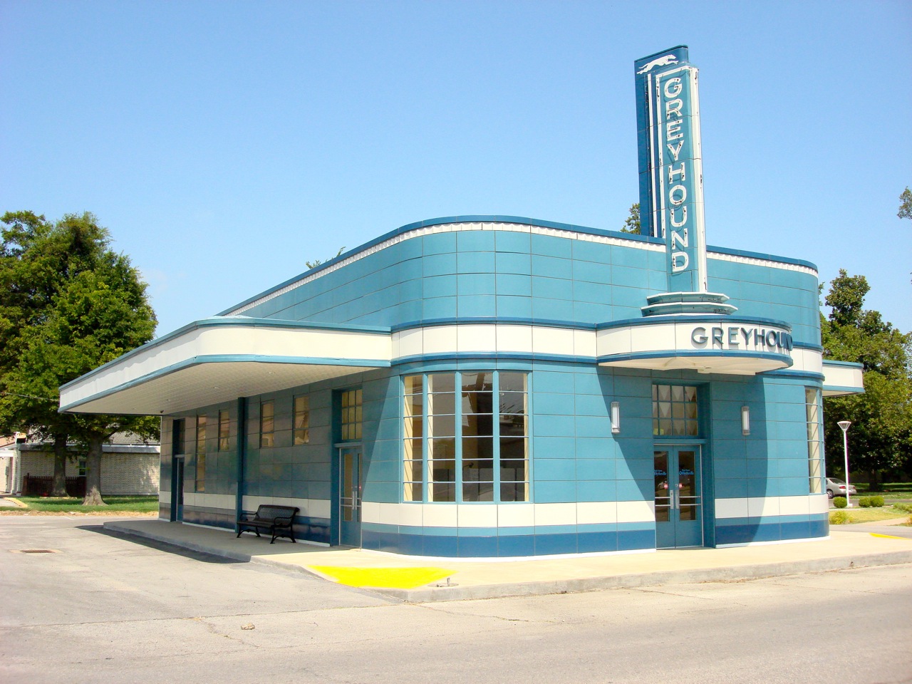

+8
Replacing the bus station seen in the background of this shot....
With this scratch bash based on the windows and base plate from the same kit. Everything else is sheet styrene scratch build.
This is the look I am going for....
https://s3.amazonaws.com/gs-waymarking-images/1440d64b-cc28-4b28-8e09-756ecb922511.jpg
Cool build Tony!  Mo' progress shots please!
