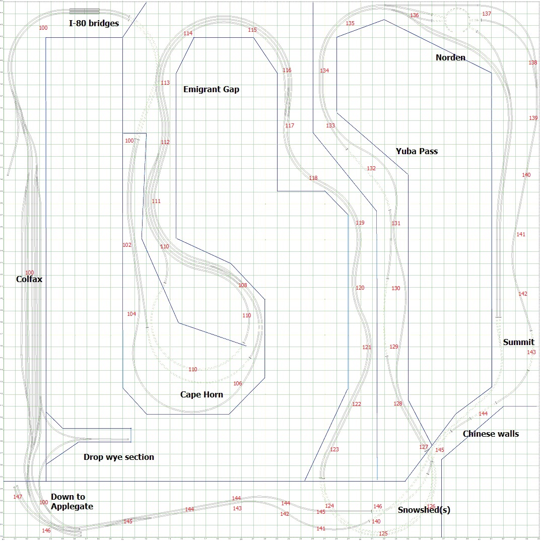

Giovanni, I think this is a very nice concept, you've obviously studied the real pass closely and I love the low staging to high staging design. One thing that I would suggest though is that your radii are much too tight at 30cm or less than 12", especially for an 1980-era mainline western railroad with six axle power and longer cars. And therein lies the dilemma, how to squeeze it all in with more realistic curvature. This is of course a very personal decision, and my personal opinion is just that, an opinion.

My goodness. That's a lot of railroad. I'm also familiar with the area, having lived close enough to railfan Donner on multiple occasions in the 1970s and '80s.
Giovanni, I feel strongly what you are proposing is too much for your space, 4.5m x 4.5m, or roughly 15' x 15'. Now that I understand that the drawing is metric and the grid is 10cm increments... it won't work. You are allowing only 50cm for your aisles, or <20". That is not sufficient for an adult to move freely. Aisles should be a minimum of 75cm, and, as Otto suggested, I would target a minimum mainline curve of 45cm, and 60cm when possible.
The idea is generally good, just too much. My first suggestion would be to eliminate the "Cape Horn" peninsula and then move the "Emigrant Gap" and "Yuba Pass" peninsula to the middle. Then let's see where we are at that point.

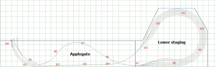

Lets start from the lower staging:
It's a compressed (very compressed) 1:160 version of Applegate flyover. On the right the tracks disappear into the non visible portion of the layout into a 5 track staging yard.
On the left, you can find the first switches to Colfax.
Track quotes are in cm (red numbers)  and are relative as they do not reflect what it will be actual elevation: you fix 100 cm at Colfax and the quotes will be adjust as you fix the elevation of the uppermost deck.
Here is the main level:
You can find Colfax, I guess it's the main yard before starting the climb to the pass. If so, it will acts also as staging for trains before starting the climb.
Out from Colfax, there will be the I-80 overpass and (new from the previus version) a NOT prototypical tunnel on the slope of the ridge before reaching Cape Horn.
In this version Cape Horn is something closer to Emigrant Gap. This let to put the ballon track at the western portion of the sidings and to use for the ballon the huge amount of Cape Horn peninsula. A portion of the balloon will be out of sight. The tracks disappear into the bush!
Passed Emigrant Gap, the tracks climb as far as Yuba Pass (track arrangement ad Yuba Pass are "flipped", sine in my version the mountain slope sits on the left when you climb to the Pass).
At Norden you find the turnable and the tracks split: the old #1 climb behind the turnable to the Pass, the #2 track and the relative siding is going to the new summit tunnel almost level!
Since the access to the room shoud be on the lower right corner, the first scene you will see is the old track #1 at the Summit / Chinese Walls / Snowshed location. In this are there will be a nod - under to acces the aisle between Yuba Pass and Nordern and another nod - under to access to the other parts of the layout.
At scenic level, the portion of the layout from the tracks emerging to Yuba Pass to somewhere east from summit will be set in early winter  or spring. I'd like to have some snow but not as much as you can expect in winter at Donner! Don't want to stop paying trains to clear tracks from snow!
To gain elevation to the uppermost level, track sits level or climbing (NOT prototypical... I'm afraid but there is no other way to reach a reasonable separation between decks).
The uppermost level is part of the east "climb" to Donner, Truckee and a scene down into the Truckee River Canyon:
At this level I found there is room only for one ballon track and I choose to design the Truckee ballon track.
To gain a continuos loop for operation, one of the snowshed covers a set of switches where the main line spits, creating a big ballong that includes Truckee and the Truckee River Canyon scene.
Hope you will enjoy viewing the track plan, feel free to apport any (positive, neutral, negative :scared: :scared: :scared:) considerations!
