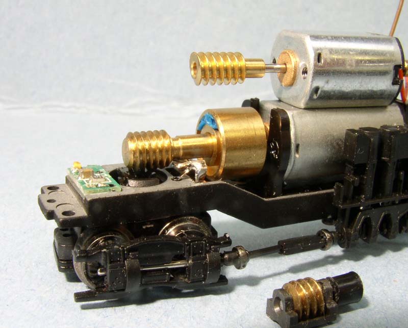

@randgust
, can you post photos of the new motor and "flyworm" assembly? I'm not familiar with the Bachmann 44-tonner motor, but I do know the Bachmann S4 motor is quite small, and the worm gears are the smallest I've seen. Maybe these could be substituted for the Atlas parts to get around the flywheel issue entirely. But, I can't say without seeing the new Shay setup.

OK, took several tries to get a decent shot of this.
This is the Bachmann 44-tonner motor perched on top of the new Atlas Shay chassis. Those of you that have one will notice the immediate difference in the motor and mounting bracket, and the new LED board instead of the spindly LED sticking up back there.
Look at the 'flyworm' and you can see what I mean. Long turning, one piece, no end hole or protruding shaft. And a very, very, fine-pitched worm.
A Kato 11-105 worm is at the bottom, and that appears to be the same pitch as the Bachmann worm. Thought of that today, nope, won't work.
