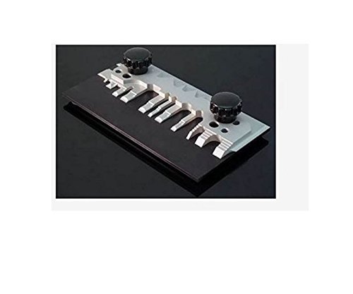

I use this with good success on phosphor bronze with 1mm wide flanges to hold.:
http://www.amazon.com/Small-Shop-Photoetch-Bending-5-Speed/dp/B00QHCWGIY?ie=UTF8&psc=1&redirect=true&ref_=ox_sc_act_title_2&smid=A2AQEEYD5Z5W05
With this mod for better grip on long thin flanges:
https://www.therailwire.net/forum/index.php?topic=39348.msg480398#msg480398

You could make the ladders separate and the fold lines wouldn't matter, because the base cage would be symmetrical.  Then half etch the ladders with rivets and CA them in place on the cage.
Say, I think you might have given me an "ah-ha!" moment here! A separately-etched 'frame' piece, with the three ladder pieces subsequently glued on, does sound like an intriguing possibility.   It could perhaps even do away entirely with the need to make long folds or solder any parts.  I'll definitely make up some pencil sketches to help me further think this through.
That's also a very interesting improvement you've made to the bending tool.  I have the small "Bug" version which has a single knob. But now I wonder if that could be part of the problem, since having only one pressure point might possibly allow the work piece to lift or slip ever so slightly during the forming.
Thanks for the great ideas!   8) 8) 8)
Ed, thanks for the kind wors and you are welcome.
While the bearing area under the knob grew quite a bit, that is not the reason I changed to the larger knobs.  It is the torque I could apply with them.  The small knobs were ripping my hands apart.  Also I found that the Bakelite knobs would stick when trying to loosen them.  The nylon washers help tremendously with this.
