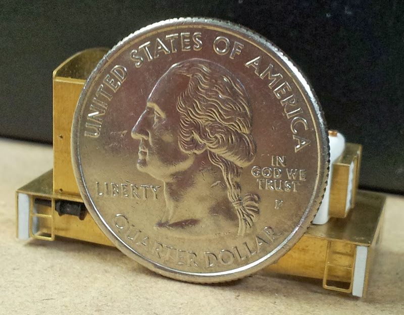

I understand how caps work with DCC. The voltage is always the same and all that. Even if I would be caught dead near a DCC system I'm betting whatever micro decoder that would fit in the cab would be around $50 or more and then there would be no room for a cap. Plus then around $300 for a throttle to make the thing move. As things are now I can run it off a single D cell battery. Remember this is Nn3. Here is a Whitcomb that is just about the same size as the Plymouth:
