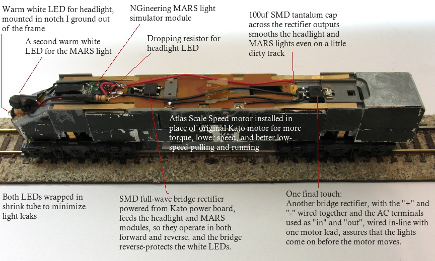

A Kato E Unit has gobs of room in it.
This isn't even a DCC job, but I put an NGineering MARS light module in it, two SMD rectifiers, and an SMD cap
(to make the MARS light flicker-free and come on before the motor starts moving).
The only milling I did on this frame was along the sides so I could put Broadway Limited shell on it.
