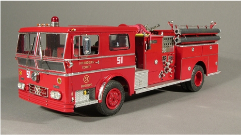

Here is my quick and dirty setup for in-progress photos of my projects (and even for beauty shots too).  When I need to take photos I bring in a portable stage and I place it on the extended top drawer of my tool chest under the desk.  The stage is just a piece of shelf board. The frame that holds the paper stage is made from flat aluminum bars . I use plastic clamps to hold the paper stage to the frame and the frame to the base board.  The stage is a paper sheet I picked up at a craft store. I have several colors (blues, grays, white and black, but I usually use the grayish blue).  What is nice is that it takes just few seconds to set it up and take down, or I can leave it in place while I'm still working on the workbench.
The illumination cannot be simpler: the circular fluorescent magnifier lamp on my workbench. I just rotate it to be over the stage. It is large enough in diameter do provide a decent and diffused light for small objects (like N scale cars).  I locate the lamp in a best spot for each photo. Sometimes straight above, sometimes off to one side or behind the camera.
The camera is on a tripod and remote release is needed for the long exposures needed under those lighting conditions.
On the camera I select aperture priority and I use the smallest possible aperture (for best depth of field.  I also always use custom white balance to give me best color rendition under that fluorescent bulb (which is 3000K).
Here are some samples of photos taken on that setup.

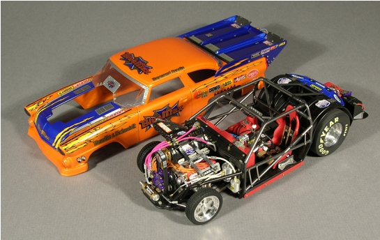

And a beauty shot.

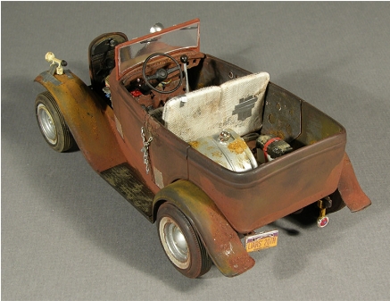

I also have a larger version of the stage for larger models (1:24 scale autos). For illumination of that one I use 2 tripod-mounted 25W halogen mini-worklights from Lowe's.
Here are some of those photos.
These are not perfect, but are still good enough to get them published.

Peteski that Engine 51 from Emergency is awesome!
  • Posts: 35440
  • Respect: +6696
Re: Lighting for Photography
« Reply #19 on: February 02, 2015, 11:23:10 PM »
Thanks, but that is not my model. I take photos at a local model car contest which get sent to Scale Auto magazine for publication. That model was scratchbuilt by Charlie Rowley - a famous modeler of fire apparatus.
