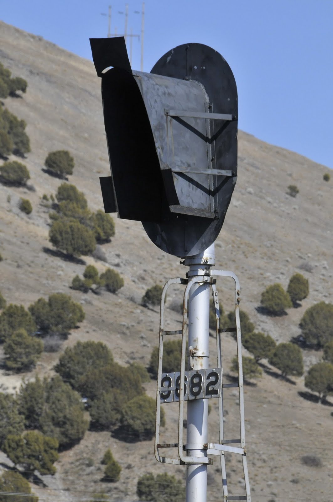

Snow hoods. They've been used on the UP in snow country since at least the late '50s. One of the Canadian asshats will have to verify whether UP was the pioneer or if it was something we imported from them. The problem they solved was blowing snow accumulating on the visors of conventional three-light color signals, blocking the aspect above, and accumulated snow in general over the lenses of approach-lit signals. They are especially vogue these days because of LED signals, which do not generate enough heat to melt any snow or ice which might stick to the lenses.
Additional benefit was better aspect visibility in glare conditions.
Aesthetically they suck, although Lennart's Safetran mid-dwarf example above (used mostly as siding exits) has a smaller hood so doesn't have that cumbersome, top-heavy look the full signals have. I like these half-size signals and hope to incorporate a few on my layout where appropriate.
I personally think they're beautiful and am sad to see they're being replaced between Ogden and Wahsatch on the Weber and Echo Canyon helper district.  Here's a prototype photo for ya...
