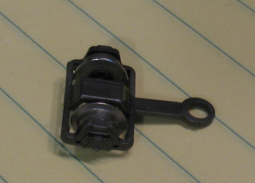

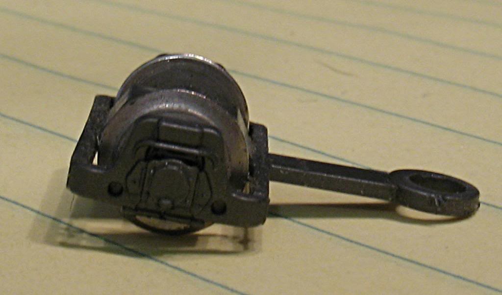

Here ya go.  I think this will do you nicely.
If you want it, send me a PM with your address.  It's yours.

Carl, I just thought of something.
That wheel has flanges that are too big for code 55 track.  I could have turned it down for you, but it's off in the mail.
Is that going to kill the whole thing for you?
