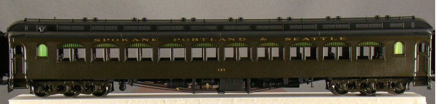

  • Posts: 6505
Re: Side tracked!
« Reply #8 on: March 27, 2014, 05:10:57 PM »
I am interested in this, as it seems quite closely match other heavyweight wooden coaches of the time
(notably ones like this SP&S beauty I would like to model) (see below).
What will you do about the glass surfaces in the arches above the windows?  They are supposed to be openings with
 Isenglass semi-transparent windows in them.
« Last Edit: July 03, 2017, 07:51:58 PM by mmagliaro »
  • Posts: 4910
  • Respect: +849
Re: Side tracked!
« Reply #9 on: March 28, 2014, 06:40:10 PM »
I was going to paint them, since they don't need to be see-through.
  • Posts: 6505
Re: Side tracked!
« Reply #10 on: March 29, 2014, 02:12:12 AM »
Good point.  With some murky yellow paint with a bit of green and brown swirling in it, they could probably
be made to look right.
