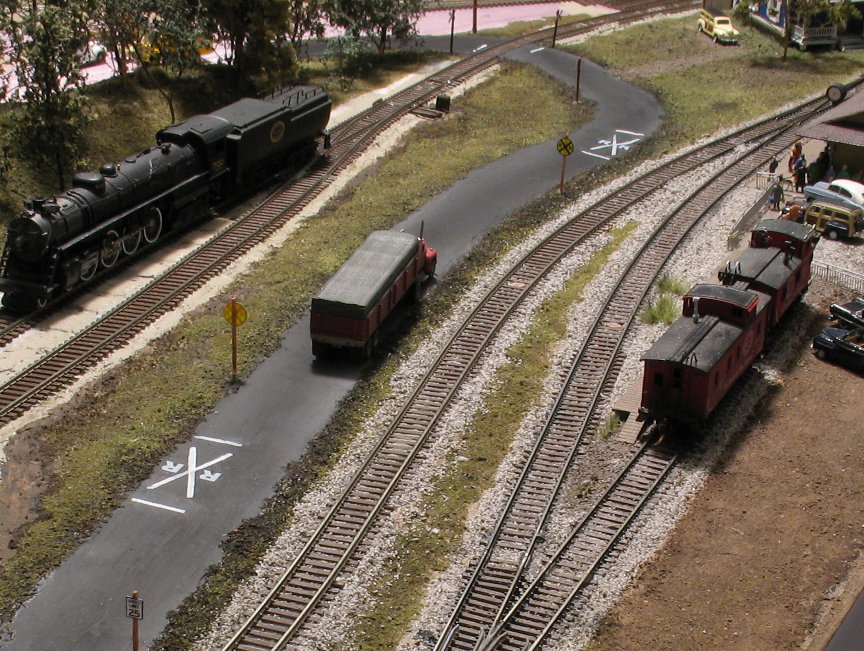

BTW, these markings are generally not located right at the crossing. In most cases, they're located around 100 feet from the crossing; there are no markings at the crossing itself.
There is a prototype for everything.  :trollface:  There are couple of crossings I go through regularly where the markings are about 40 feet from the track.  Perfect distance for N scale layout.  Here is one of them.

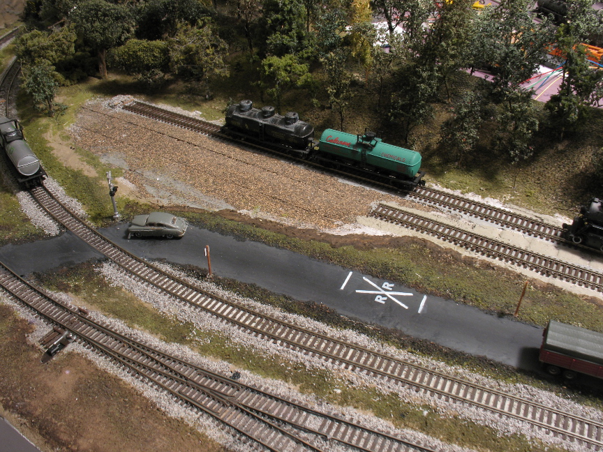

There is one of those near my house too, Peteski.   If the roadway speed is lower, or if there is a short stretch of road between the preceding turn or corner and the tracks, they seem to place the "X"'s closer to the tracks.
Yours also looks odd in that the legs of the "X" look thicker to me than on other examples.
Another plus in your case is that the "X" isn't as elongated, so almost-normal letter "R" decals or transfers
would do.
I actually ended up just carefully drawing out the "X" on masking tape, and cutting out a stencil with a steel straight edge and
a sharp Xacto knife.  Tape the stencil down, and paint the X in white paint.  I did the same thing for the stop lines
at the tracks.  Then I got some large "R" decals that came in that decal set I mentioned at the start of this thread.
(I didn't use their "X", just the big "R"'s).
The proportions ain't perfect, but it's good enough for me.  Oh, and the decal "R"'s had no trouble settling onto the uneven
road surface.  The key is Solvaset.  And after it's fixed in place, do 2 or 3 more applications of Solvaset.  No shine, no film.
It's great stuff.  ( I know people have had it eat their decals, but it's always worked great for me).

For your (apparent) era, with the old cars and steam loco, road markings weren't as standardized as today.  It looks fine from here.
