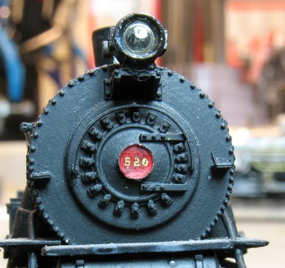

It looks like this from the front:

...ok I'll be "that guy" and ask why the that is red instead of black.

It's red because I did it a long time ago, didn't pay any attention to the fact that freight number badges were
black (instead of red like the keystones), ands never bothered to fix it.

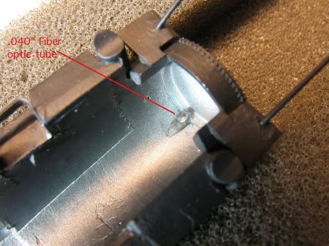

As for how the light is mounted in the correct spot...  I did a similar thing to what you did, Cody, but I drilled my hole on a 45 degree
angle down through the lower back corner of the headlight housing, instead of straight down.  The upper edge of
the boiler has a hole drilled in it to match.  The fiber optic tube then snakes down through the front at a 45 degree angle
into the boiler.  Now, with the tube still sticking out of the housing, say, an inch or more, at a 45 degree angle, THAT's
when I held the soldering iron near it to mushroom it.  And you can get it to mushroom on an angle so that when it is
pushed into the housing, the lens it nice and straight, even though the tube itself goes down at an angle behind it.
When it's all mounted, a drop of 2-part epoxy and a drop of black paint, if necessary, will hide anyplace where things
don't go quite right (i.e. if the hole or the tubing shows).
I don't have enough other photos to quite show it, but this one might help, from the inside.
