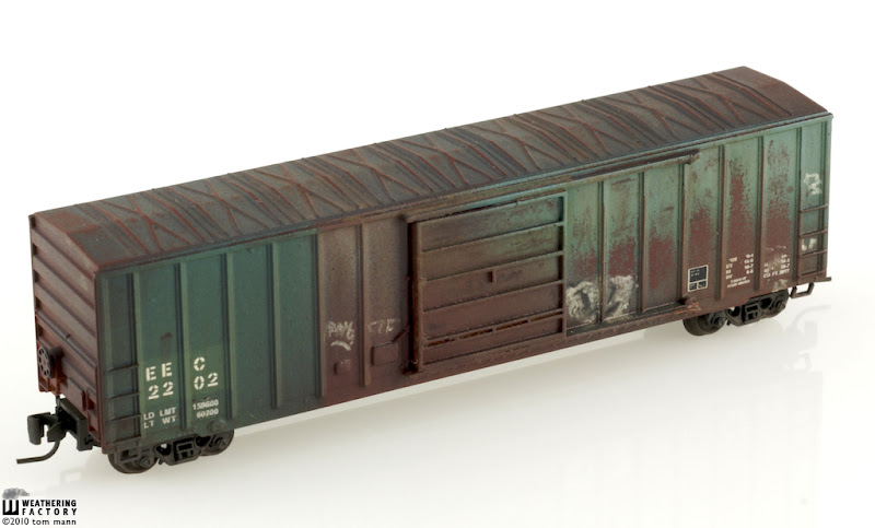

Well, I tried to match the colors at least 4 times, but failed.  This still isn't close, but the model cant take any more layers of paint ;D ;D
I wanted to do this in Z scale, to take advantage of new doors and door track from Robert Ray.
edit:  I should mention that this is the best I could do given the short deadline. ;)

Looks great Tom!  In your earlier post you complained about the color being too gray, but to me the prototype looks grayer than the model.  Is this really grimy black & yellow?
Could you tweet a few bullets on methods and order of operations?  Paint the green, then use the surface rust treatment from the GWIX thread, or something else?
It's hell working to a deadline...
Re: Shortline Boxcar Group Effort
« Reply #48 on: June 09, 2010, 09:02:30 PM »
Gary,
I started with the Rust base coat made with spray paint as described in my book (funny, but I actually started this model a few years ago!).
The green shades were made using Grimy Black and Reefer Yellow initially, but I was also mixing Undercoat light gray.  I don't really know what I ended up with - I just mixed and mixed until I gave up ;D  Serious ;D  But follow up with the GWIX treatment.
