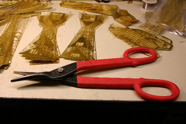

I just use scissors.

Available at Home Depot
