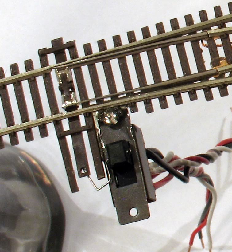

I've never had problems using ACC with Atlas ties. I don't know about the ground throws though. If I had to try it I would sand both surfaces with something like 120 grit before using ACC.
I used small switches to throw Atlas turnouts, but I ACCed styrene to the bottom and installed the switch to that:
