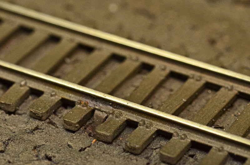

Here's a photo of a PCB tie feeder that's been painted prior to the last show to hide it.  Code 40, hand-laid track, every fifth tie is a PCB.

Here's a photo of a "virgin" under-rail-foot-feeder, which means it was done before painting, weathering and ballast...like it SHOULD be done!
Here's a photo of a "virgin" under-rail-foot-feeder after the rail has been painted.  As you can see, it's starting to disappear.
