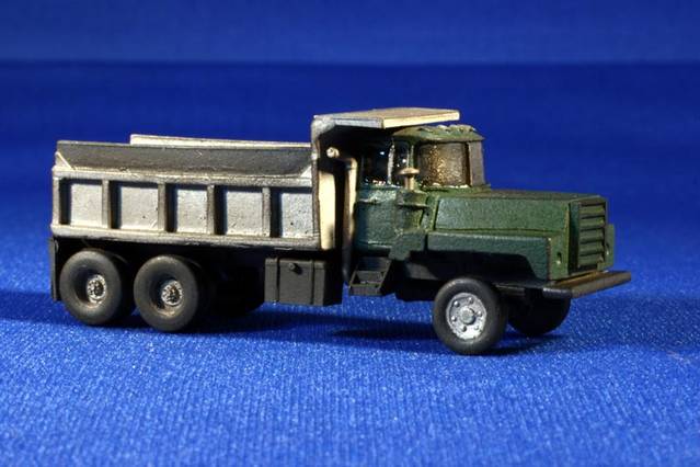

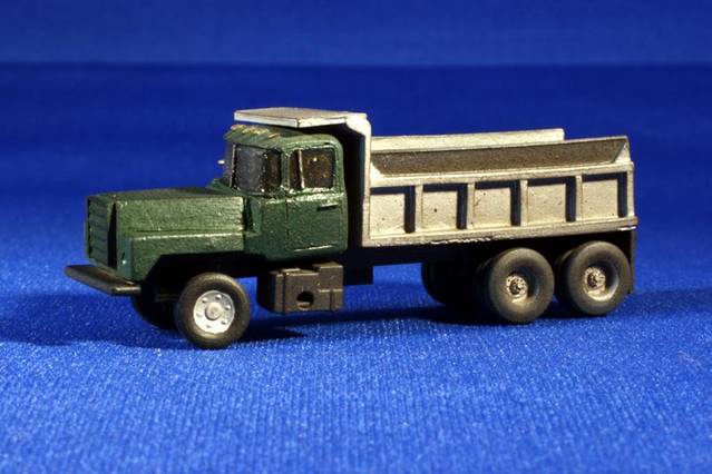

I have many Lineside/Road Apple vehicles, and there are a lot of issues with most of them. The Mack DM800 cleans up nice though:
