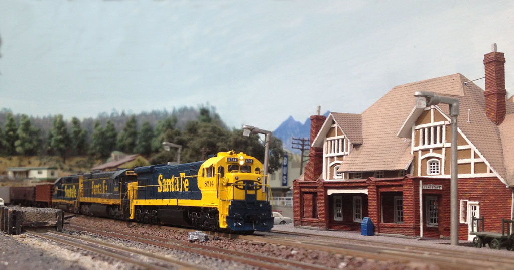

I don't know San Diego so I'll hedge big time and say 'I don't know'.
But as general ATSF practice, yeah, they are left outside and unless there's a backshop involved, rarely inside.  But that's why I mentioned the car shop, so that if you like the Rix building look, you still have a very valid reason to use it.
If you look again at this recent shot, the backdrop is done with photos mounted on a sky-blue Masonite backdrop with blended white-to-blue, no clouds, I don't have the talent.  But the distant trees, and the San Francisco Peaks - are all done from photos glued on it with the sky cut off.   I wanted 'dead accurate' color and perspective from this particular photo angle and compared real shots from the same place to get it.  I took the Peaks shot from that location when I was out there.
http://www.randgust.com/U36C%208714%20Flagstaff%20sm.jpg
A technique I used for the trees is using Photoshop for horizontal image flipping of a 'chunk' of scenery; i.e. simply reverse a photo horizontally and reprint it again.  That works for basic hills and trees, and your edges and colors always match up perfectly at edges.  You can make sheet after sheet after sheet of 'distant' backdrop using 8 1/2 x 11 paper and your own printer.   That's how the far distant trees are done in that shot.  I've got about five feet of scrub scenery east Winona right on the backdrop that sorta looks like your hills.
