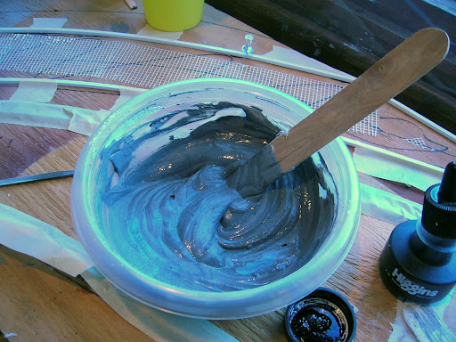

I just pinned down some square styrene rod I had lying around. After the plaster hardened a bit, I removed the forms and worked in the slope with  the back end of a tweezers.
Thought so. I'm going to give it a shot. I've heard using double sided tape works too but, I think this is a better method. Thanks.
I used tape and the Walthers paving tape but I like this idea better as it is cheaper over the long run. Although I have been using bass wood square dowels, so I am going to pick up some square styrene rod so it will last longer. After a while the bass wood breaks. I still use the Walthers paving tape with the wood dowels if I need to make tightly rounded corners.
using Spackle/drywall-mud is easier, and cheaper too.  I just didn't have any around this time and didn't feel like taking a drive ;)
